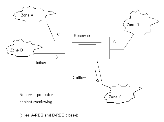

Closed pipes case 1
A reservoir is protected from excessive inflows by closing down some neighbouring pipes.

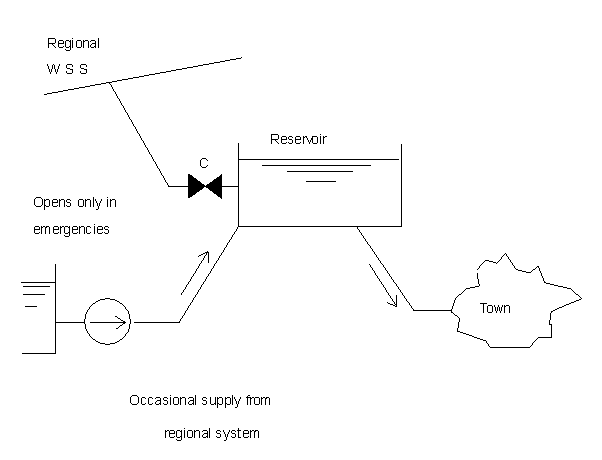

Closed pipes case 2
A small town is supplied by its own local water supply system most of the time, but in an emergency can get additional quantities from a nearby regional system.
