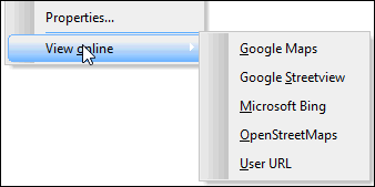

- Right-click the location/ object of interest on the GeoPlan, select View online, then choose the desired map service.

Online map availability on the GeoPlan context menu is configured in the Online Map Options dialog. Supported types include:
- Google™Maps
- Google™ Street View
- Microsoft™ Bing
- OpenStreetMap
- User-defined URL

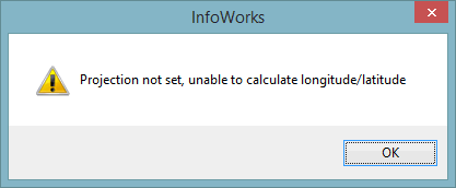

- If no coordinate system has been set, a warning message will be displayed. In this case, click OK on the message, set an alternative coordinate system, then restart the procedure from step 1.

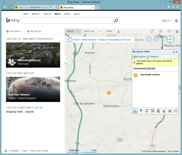

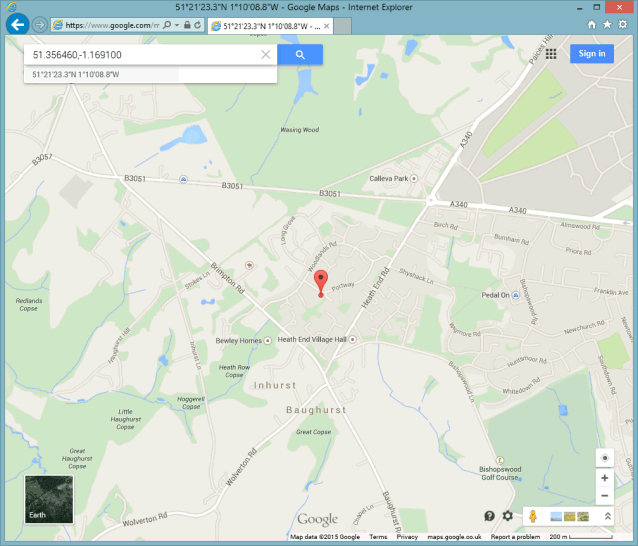

If no warning message similar to the one described above is displayed, the selected web mapping software is opened using the default browser. The map opens with the location/object corresponding to the GPS coordinates that have been clicked on the GeoPlan highlighted on the map. By default, the map will be centred on these coordinates.
GoogleMaps
Microsoft Bing
