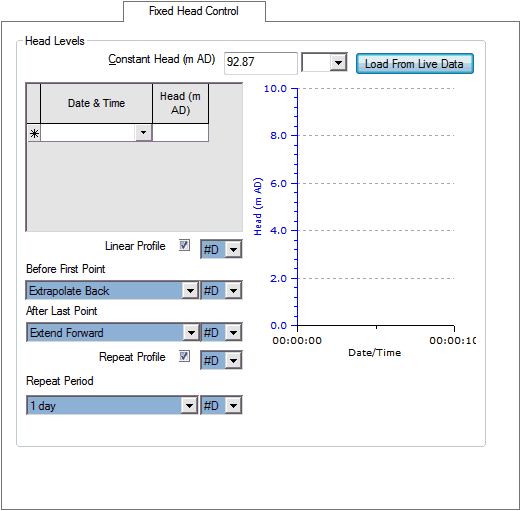

This page allows you to view and edit all the fixed head node specific data fields.
The page is displayed by clicking the Fixed Head Control tab on the property sheet for a fixed head that has control data added.
There are two ways to set up the head level for a fixed head node:
- Use the Constant Head field to set a head level that is constant throughout the simulation.
- Use the grid to enter a series of variable head levels for the simulation.
By default, linear interpolation is used between data points. Uncheck the Linear Profile box to use a stepped profile: each head value entered in the grid will be maintained until the next date / time entry, or until the end of the simulation.
Options for extending the profile outside of the entered dates / times
The page has options for extending the profile outside of the entered dates and times.
| Option | Description | ||||||
Before First Point |
After Last Point |
Repeat Profile Checkbox |
If checked, repeats a profile (from 00:00 for the selected Repeat Period) for the duration of the simulation. Important: When using the Repeat Profile option, if the defined profile spans over the selected repeat period, the profile will not be repeated.
Repeat Period |
Profile period which will be repeated throughout simulation, if the Repeat Profile box is checked. |
