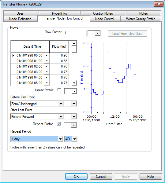

Transfer Node Flows Grid
The Transfer Node Flows grid defines the transfer schedule for the node. Each entry is the date and time of a change in the transfer volume.
The Flow Factor is a scaling factor used in conjunction with the Flow grid to produce actual flows. Resulting positive flow values represent flow into the system, negative values represent flow out of the system.
By default no interpolation is used between data points. Each transfer flow entered in the grid is maintained until the next date / time entry, or until the end of the simulation. Check the Linear Profile box for linear interpolation to be used between data points.
The following options are available for extending the profile outside of the entered dates / times:
| Data Field | Description | ||||||||
Before First Point |
After Last Point |
Repeat Profile Checkbox |
Check the Repeat Profile box to repeat a profile (from 00:00 for the selected Repeat Period) for the duration of the simulation. Note: When using the Repeat Profile option; if the defined profile spans over the selected Repeat Period, the profile will not be repeated.
Repeat Period |
Profile period which will be repeated throughout simulation, if the Repeat Profile box is checked. |
