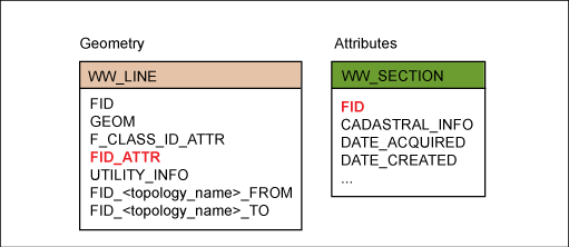

Because geometry and attributes are stored separately, one geometry features class, such a point, can reference various attribute feature classes, such as manhole, cover, fitting. For line features this allows for two different line splitting methods: soft split and hard split.
Wastewater data model: Relation between section and line feature class

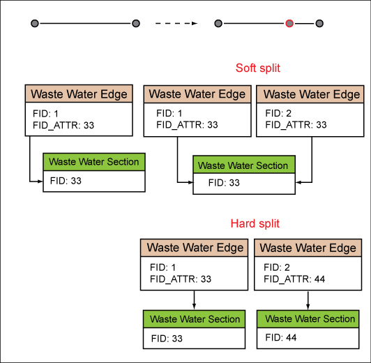

Using a workflow you can decide whether the line is soft split or hard split, thus determining how the system handles the attribute data of the two resulting features.
Split
Description
Soft Split
A soft split breaks the line into two separate features, each with its own geometry (WW_LINE) but sharing the same attribute data (WW_SECTION).
Use soft split for point features of minor importance and when the attributes of the section do not change.
Hard Split
A hard split breaks the line into two separate features, each with its own geometry (WW_LINE) and attribute data (WW_SECTION). In a hard split the attribute data is not shared.
Use hard split for point features of major importance or if the attributes of the section change, for example diameter, material, model.
Wastewater data model: Soft and hard split
