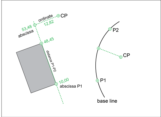

Use the Orthogonal Calculation function for orthogonal surveying in an enterprise industry model . The base element is either represented by an existing line or it can be defined by using two points which can lie aside. When calculation is performed, measured and calculated dimensions are taken into account.
Orthogonal calculation elements
