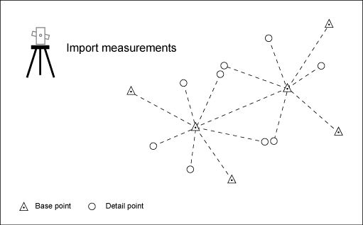

Import Measurements
The second calculation step loads the measurements to the Survey database. You can import measurement groups, that means multiple files, each of which has been measured by one operator, using one instrument.
For example, in one measurement group you import multiple tachymeter files containing a polar mapping, and in another measurement group you import several GPS sessions.
For each set of import files, you specify the instrument. The import function reads the records of the import file, stores the measurements in the Survey database, and applies the a priori standard deviations, as specified in the instrument settings.
