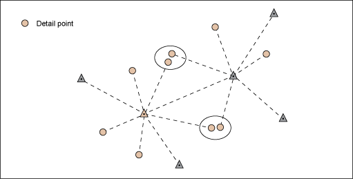

In the fifth calculation step, you identify points that have been measured more than once. The approximation in the previous calculation step results in coordinates for each point. Usually, for identical points, these coordinates are slightly different.
For the adjustment, identical points have to be merged and introduced as one unknown.
The Find Identical Points function detects identical points by identifier, field code and location, as specified in the field code list. For points that exceed the tolerances, you are prompted to analyze the search results manually.
For example, if two points with different field codes lie within the tolerance, you would keep both points, if they represented two different real world objects. Then, they were both included in the adjustment calculation.
