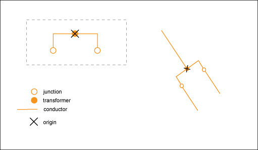

If you group template features, you can move or rotate the feature arrangement as a single entity. However, you cannot move the components separately when you instantiate it. This behavior is controlled by the feature rule Update Template Instances on the feature classes that are part of the template.
Example—This template for an electric feature arrangement consists of a transformer, two junctions, and two conductors. Using this template, you can instantiate the five objects and apply their attributes and connectivity with a single mouse click. The template is grouped: you can place and move it as a single entity. After that, you can continue to digitize the conductors.

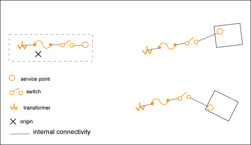

Example—This template for an electric feature arrangement can be used in residential areas to create the connections to service points. In residential areas, service points are commonly connected to a transformer using identical feature arrangements. A template speeds up data acquisition in this situation. This feature arrangement is not grouped: you can instantiate the template and then move each service point individually to its exact location without moving the other features.
