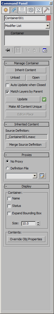

Corresponds to the "Auto Update when Closed" checkbox in the Container's UI.
<Container>.duplicateMatchingLayers     BooleanClass    default: true   --  boolean; Match_Layers_by_Parent
Get/set the state of the "Match Layers by Parent" checkbox.

Content RulesProperties
The content rules are stored with the .MAXC asset file and control how the content will behave when inherited by a container.
<Container>.allowInPlaceEditing BooleanClass default: false -- boolean; Allow_In_Place_Editing
Get/set the In Place Editing Container Rule.
Corresponds to the state of the "Allow In-Place Editing" checkbox in the Container's UI.

Display- ContainerProperties
<Container>.displayLabel BooleanClass default: false -- boolean; Display_Label
Get/set the state of the Name checkbox. (called "Label" in 3ds Max 2010).
When set to *true* , a text label appears next to the Container to show its Name.
<Container>.displayStatus BooleanClass default: false -- boolean; Display_Status

<Container>.contentBoundingBox BooleanClass default: false -- boolean; Content_Bounding_Box
Get/set the state of the Expand Bounding Box checkbox.
When set to *true* , a bounding box of the container will expand to enclose the content.

<Container>.overrideNodeProperties BooleanClass default: false -- boolean; Override_Object_Properties
Get/set the state of the "Override Obj Properties" checkbutton.
When set to *true* , the content will display using the Container's display properties including wireframe color, visibility settings, and so on. If the content is set to use properties By Layer, the Container's Layer will be used instead of the content's Layers.
When set to *false* , the content will display using its own display properties.
