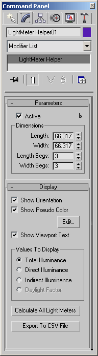

The LightMeterHelper allows the generation of lighting analysis data on a custom grid in world space. It works in conjunction with the Lighting_Analysis_Overlay : RenderEffect
Constructor:
LightMeter...
Properties:
Parameters
<LightMeter>.active BooleanClass default: true -- Boolean
Get/set the state of the On checkbox.
Dimensions
<LightMeter>.length Float default: 1.0 -- animatable; worldUnits
Get/set the Lengthof the LightMeter.
<LightMeter>.width Float default: 1.0 -- animatable; worldUnits
Get/set the Width of the LightMeter.
<LightMeter>.length_segs Integer default: 3 -- integer
Get/set the Length Segments of the LightMeter.
<LightMeter>.width_segs Integer default: 3 -- integer
Get/set the Width Segments of the LightMeter.
Display
<LightMeter>.showOrientation BooleanClass default: true -- boolean; Show_Orientation
Get/set the state of the Show Orientation checkbox.
<LightMeter>.showPsuedoColor BooleanClass default: true -- boolean; Show_Pseudo_Color
Get/set the state of the Show Pseudo Color checkbox.
<LightMeter>.showViewportText BooleanClass default: true -- boolean; Show_Viewport_Text
Get/set the state of the Show Viewport Text checkbox.
Values To Display
<LightMeter>.valuesToDisplay Integer default: 0 -- integer; Values_To_Display
Get/set the selection of the Values To Display radio buttons list.
Possible values are:
0 - Total Illuminance(default)
1 - Direct Illuminance
2 - Indirect Illuminance
3 - Daylight Factor
