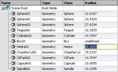

EXAMPLE USAGE:
--Define a getter function which returns the radius property
--if it exists or implicitly undefined when no such property
fn getRad theNode = (
if isProperty theNode "Radius" then theNode.Radius )
--Define asetter function which sets the radius property
--if it exists otherwise does nothing
fn setRad theNode theValue = (
if isProperty theNode "Radius" then theNode.Radius = theValue)
--Add a Property filter to the Scene Explorer Manager with the name
--"Radius" and the two functions as second and third argument
SceneExplorerManager.addProperty "Radius" getRad setRad
--Define a getter function which returns the class of the node
fn getClass theNode = (classof theNode)
--Add aRead-OnlyProperty filter to the Scene Explorer Manager
--which can only get properties but cannot set them
SceneExplorerManager.addReadOnlyProperty "Class" getClass
Once evaluated, the new properties will appear at the end of the Column Chooser dialog:
Drag the new columns to a Scene Explorer to see the class of all scene nodes and the radius value of any scene node that has a .radius property:
