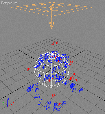

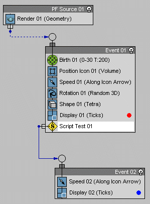

In the Init handler, the Script_Test creates a unqiue Age Test action or accesses an existing one if already created before. It then calls the Proceed methods of the Age Test to acquire its test results. Then it takes only the particles that have not passed the Age Test and checks them against a spherical volume. Those that fall inside the volume pass the Script Test, too.
The particles that tested True are passed to a second Event which stops them. The final result is that all particles either stop because they are too old, or stop because they have entered the spherical volume.
In the sample scene, a Sphere with radius 20 represents the spherical volume tested by the script. The particles either rest on the surface of the sphere, or have passed it and have stopped because of their age outside the sphere.
