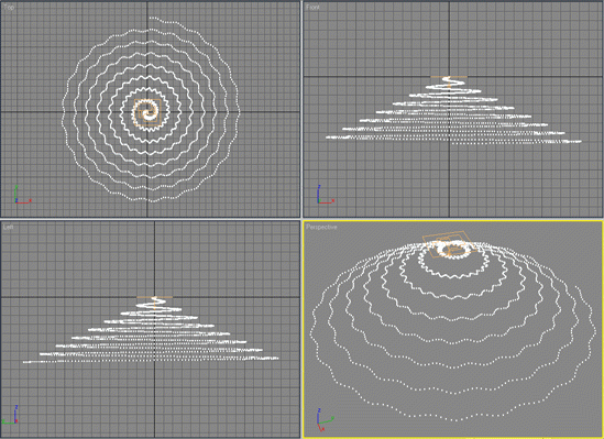

Effect:
The script generates a nice particle pattern - a helix built by a sine curve. In order to see the effect of the script, you should:
  • Create a default PF_Source in the scene from the Create Tab of 3ds Max.
  • Open Particle View
  • Replace the Birth action with a Birth_Script action
  • Delete the Speed, Position and Rotation operators.
  • Scrub the Time
