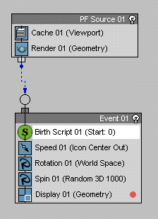

Should be used in a Birth_Script Action to generate fragment particles.
Effect:
In the Init handler, the script prepares the fragment source object, a PArray, a Mesher Compound and two Editable meshes to hold the fragments. It then assigns the PArray to the Mesher.
In the Proceed handler, the script checks whether the particle system time is at frame 0 and no particles exist. In this case it gets the mesh of the PArray from the Mesher, splits the mesh into elements, gives birth to new particles and assigns them the mesh and position of the fragment.
After the script has created the particles with the fragments, they can be controlled by any Particle Flow operators as usual.
