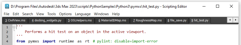

  • Tabbed Display - multiple Editor Windows can be opened in the same time within the same user interface.
    • By default, up to 10 files can be opened either one by one or by selecting multiple files in the Open File dialog. The Editor supports up to 100 files opened at once - it can be customized to do so, but only the first 10 tabs will be directly accessible via the Alt+number key described below.
    • The first 10 tabs are numbered as 1,2,3,4,5,6,7,8,9 and 0 - you can switch to a tab directly by holding down the Alt key and pressing the number of the tab from 1 to 0.
    • If there are more opened tabs than possible to fit in the tab bar at the same time, two scroll arrows will appear at the right side of the tab strip allowing you to scroll the tabs. Also, clicking on the left-most or right-most tab will attempt to center it and thus shift the tabs to reveal more tabs that might be eventually outside the view.
    • You can cycle the tabs using the CTRL+Tab keys or CTRL+SHIFT+Tab for cycling backwards.
    • Scripts that require saving because of editing changes will be marked with a * star in both the tab and in the title bar.
    • Right-clicking a tab displays a context menu with the options to Close, Save, Save As and Print the document represented by the tab.
    • Middle-clicking a tab closes it immediately if the file does not require saving or prompts for saving if it has been modified.

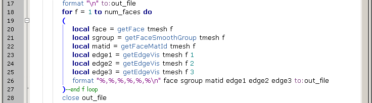

  • Folding Code Blocks - portions of the code between parentheses can be collapsed by clicking on the minus sign to the left of the opening parenthesis. Alternatively, press Ctrl+SHIFT+Plus on the top numeric row (next to the Backspace key) to toggle the folding of the code block the cursor is currently in.

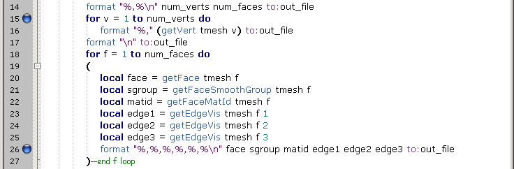

  • Bookmarks - an arbitrary number of bookmarks can be placed at any number of lines using CTRL+F2. To jump to the next bookmark, press F2 , for the previous bookmark, press SHIFT+F2.

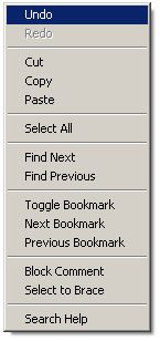

  • Right-click context menu - some often used commands are hard-coded in the context menu which appears when right-clicking in the Editor window. This menu is customizable and can be extended by the user - See Scripting Editor - Defining Custom Context Menu Items for details.

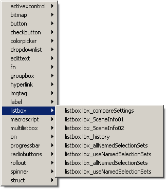

  • Jump to code blocks - like in the legacy Editor, holding down the CTRL key and right-clicking in the Editor opens a context dialog listing various code blocks like function definitions, rollout definitions, event handlers, UI controls and so on. Selecting any of them repositions the cursor to that definition:
