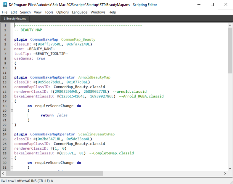

The Scripting Editor is a built-in editor you can open within 3ds Max and use to create or edit text files, notably MAXScript and Python script files. Scripts can be executed from the editor. The editor also provides syntax highlighting for other common text formats, like HTML and XML.
To open the Editor,
  • Click MAXScript > Scripting Editor... in the 3ds Max Main Menu to toggle the new Editor window. Any scripts that have been open for editing will be kept in the Editor, even between 3ds Max sessions.

MAXScript opens the selected script in a tab inside the modeless Scripting Editor window:
The Scripting Editor is suited for developing longer scripts or code fragments you want to keep. You can edit and test parts of them until they are complete, then save your code in a script file for later use. This is a common method for developing large scripts, utilities, and function libraries.
