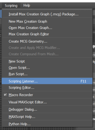

You can open the Scripting Listener from the Scripting menu in the Main Menu: MainMenu > Scripting > Scripting Listener.
Note that the default keyboard shortcut to the Scripting Listener, F11 , is also listed next to the menu item. You can press F11 anytime to open the Scripting Listener.

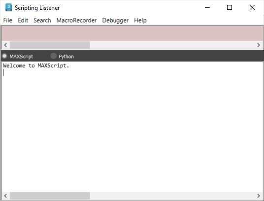

The Scripting Listener window appears with its Welcome message.
The Scripting Listener window is an interactive interpreter for the MAXScript language and works similarly to a DOS command prompt window. You can enter MAXScript commands in this window and press the numeric ENTER key to execute them immediately.
