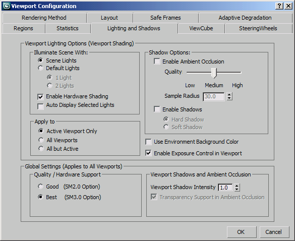

IViewportShadingMgr.AutoDisplaySelLights : boolean : Read|Write
Get/Set the state of the "Auto Display Selected Lights" checkbox in the "Lighting and Shadows" tab of the "Viewport Configuration" dialog. When set to true, the currently selected lights will be enabled to illuminate/cast shadows, while unselected lights will be off. When set to false, all lights will be turned on.
IViewportShadingMgr.DefaultLightCastShadows : boolean : Read|Write
Get/Set the state of the "Cast Shadows for Default Light" checkbox in the "Lighting and Shadows" tab of the "Viewport Configuration" dialog. When set to true, the default lights will cast shadows. When set to false, default lights will not cast shadows.
IViewportShadingMgr.GlobalShadowIntensity : float : Read|Write
Get/Set the value of the "Global Shadow Intensity" spinner in the "Lighting and Shadows" tab of the "Viewport Configuration" dialog. Controls the intensity of the viewport Shadows. When set to 0.5, shadows will be 50% less dense.
