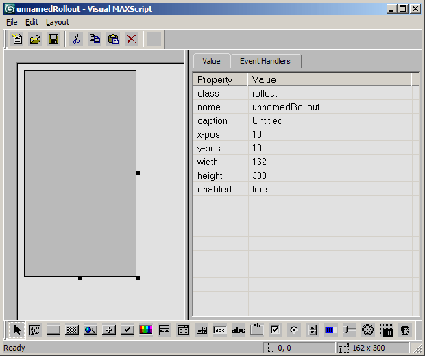

Visual MAXScript is a direct-manipulation, multithreaded, forms-based editor that you can use to layout and edit MAXScript rollouts. Rollout scripts can be created from scratch in the forms editor, or use it to interactively edit and add to an existing rollout definition in a script editor window.

    • You add new UI items by clicking its button in the item toolbar at the bottom and then dragging out a rectangle for it in the main form. You can select an existing item and edit its parameters in the property list on the right. You can select multiple items by fence-dragging or ctrl-clicking and perform various alignments operations, see the Layout menu. A selected item can be deleted by clicking the red X toolbar button. The various panes can be resized or even torn off if you want to customize the editor layout.
