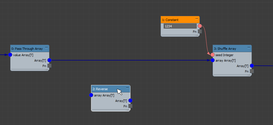

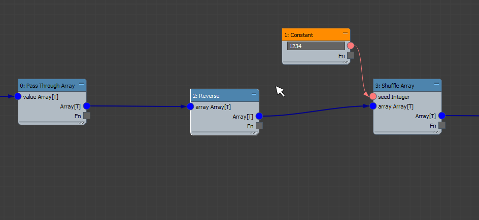

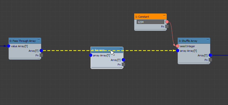

Wiring
To quickly connect a node onto an existing wire, begin by clicking and dragging on the node to move it.
Hold the Ctrl key and place your cursor onto the wire. When the dotted yellow line appears, you may release your mouse button to insert the node.
The node's compatible ports will be connected onto the wire. If more than one port is compatible, the available options will be listed in a small box.
Hold the Alt key as you drag a node to remove it from its connected wires.

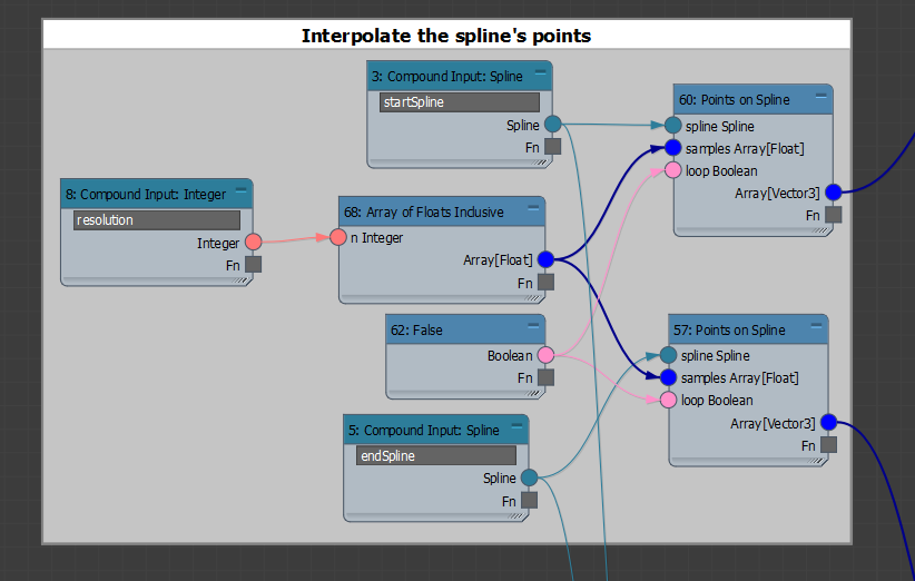

Grouping
Use groups to organize your nodes and to add comments to your graphs. To create a group, select the nodes, right-click to open the context menu and select Create Group Node.
Double-click on a group's titlebar to edit its title.
Double-click on a group's body to edit text in a smaller font.
Right-click on a group to open its context menu to Change Background Color and to enable Auto Fit to Content to ensure it wraps around its contained nodes.
