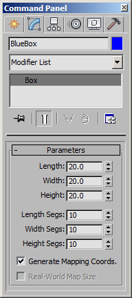

The following lines prepare our box for more complex transformations. They change the number of box segments on all sides, and put a check mark into the Generate Mapping Coords. box in the Parameters rollout:
ENTER THE FOLLOWING FOUR LINES OF CODE:
   mybox.lengthsegs = 10
   mybox.widthsegs = 10
   mybox.heightsegs = 10
   mybox.mapCoords = true
MAXScript has changed the appropriate settings in the Parameters rollout:

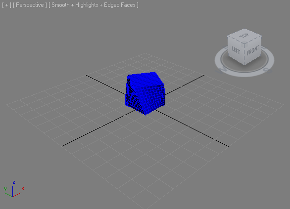

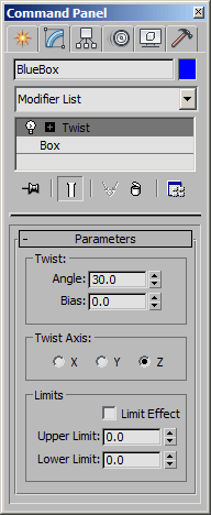

To create a Twist modifier set to 30 degrees and apply it to your box,
ENTER
   addModifier mybox (twist angle:30)
The box in your Perspective viewport is now twisted and the interface shows the new Twist modifier in the modifier stack display, together with its parameters:

To change the angle of the twist modifier to 60 degrees,
ENTER
   mybox.twist.angle = 60
The twist of your box is now more pronounced and the Angle parameter of the Twist modifier displays the new value:
