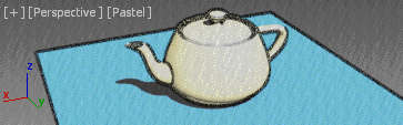

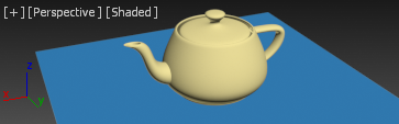

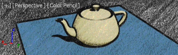

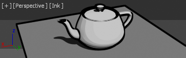

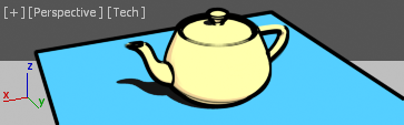

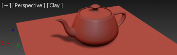

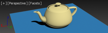

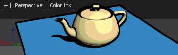

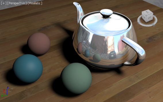

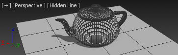

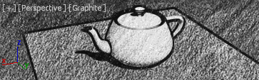

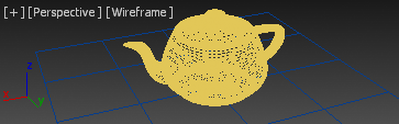

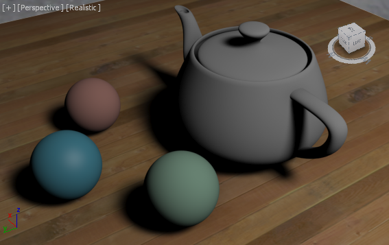

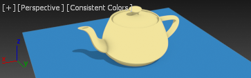

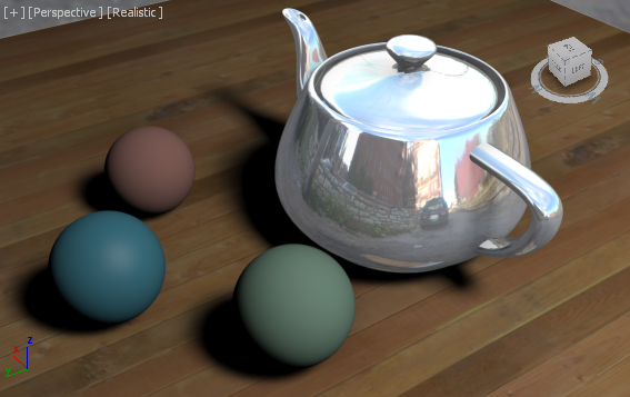

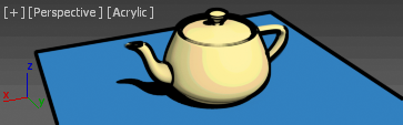

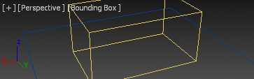

Numeric Value Enum Name UI Name Example
0 #Realistic Default Shading Mode
1 #Shaded Shaded
2 #Facets Facets
3 #ConsistentColors Flat Color
4 #HiddenLine Hidden Line
5 #Wireframe Wireframe Override
6 #BoundingBox Bounding Box
7 #Ink Ink
8 #ColorInk Color Ink
9 #Acrylic Acrylic
10 #Tech Tech
11 #Graphite Graphite
12 #ColorPencil Color Pencil
13 #Pastel Pastel
14 #Clay Clay
15 #ModelAssist Model Assist
