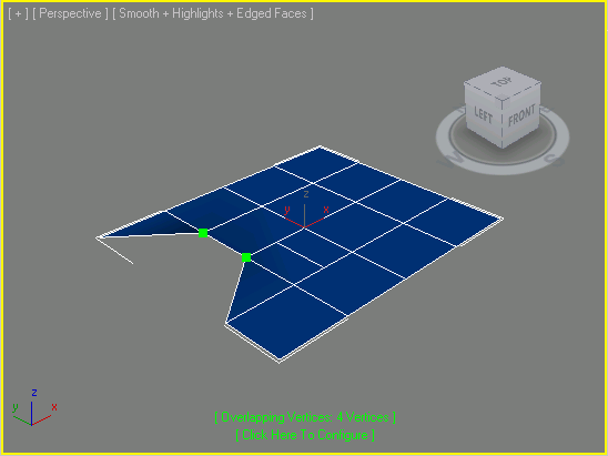

Interface: OverlappingVertices
The OverlappingVertices Core Interface exposes methods for interacting with the Overlapping Vertices xView Checker.
Available in 3ds Max 2010 and higher.

<enum>OverlappingVertices.Check <time>time <node>nodeToCheck <&index array>results
Check enums: {#Failed|#Vertices|#Edges|#Faces}
results is In and Out parameter Performs an Overlapping Vertices xView check at the given time on the specified node and returns its results in the array passed by-reference as third argument.
The method itself always returns the #vertices enum because the values written to the results array always represent the indices of overlapping vertices.
