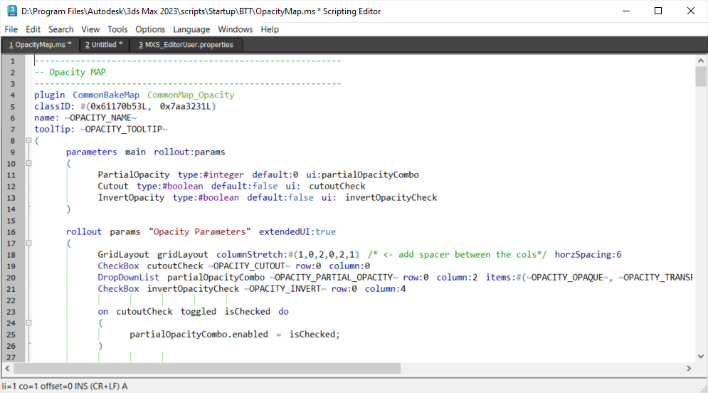

Here is the shipping \\scripts\\Startup\\BTT\\OpacityMap.ms file using the default color scheme:

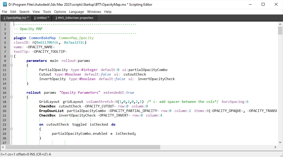

After saving a new "MXS_EditorUser.properties" file containing the color definitions listed in the beginning of this topic, the same script looks like this:
Changing the property properties.directory.enable=0 and saving the "MXS_EditorUser.properties" file to disk will instantly change the color coding back to the default color scheme in all currently opened tabs showing MAXScript files.
