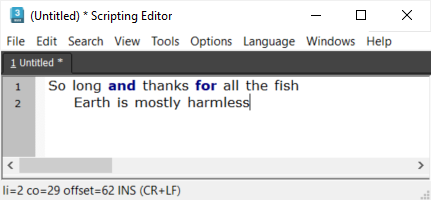

Open the Scripting Editor.
Create a new Script and enter in it: "So long and thanks for all the fish.[New Line] Earth is mostly harmless"
The result should looks like this:

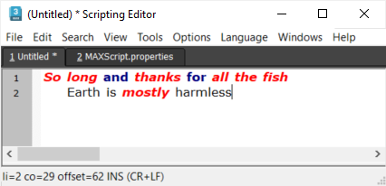

#keywords12 is for user defined words to be colorized. Keywords are checked for in this list first.
You can add keywords to the keywords12.$(file.pattern.MAXScript)= definition. Make sure to use \ at the end of each new line.
For example, enter the following words: so long thanks all the fish mostly harmless
Press Ctrl+S to save the file MAXScript.properties.
The resulting formatting should look something like this:
Modifying The Color And Style Of Custom Keywords
As you can see, the default color for user-defined keywords is red and the style is bold italic.

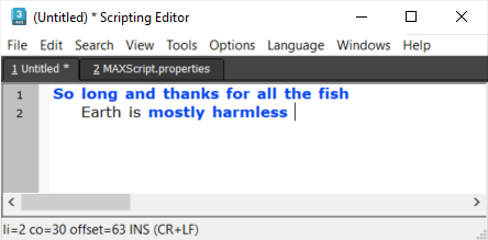

For example, remark the existing line using # and enter the following instead:
style.MAXScript.23=fore:#0040F0,bold
Then press Ctrl+S to save. The result will be something like:

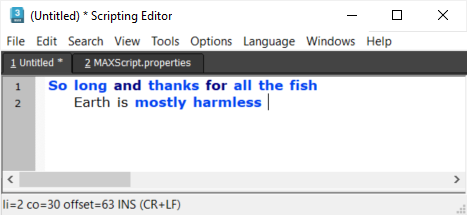

As mentioned in the remark to the keywords12 definition in the MAXScript.properties file, keywords are ALWAYS checked for in the user-defined list before checking the language-specific definitions (which in the case of MAXScript are exported automatically).
In the above example, the keywords "and" and "for" are colorized as part of the language (logical AND operation and FOR loop). If we would include them in our custom keywords list, they would be colorized in brighter blue instead of dark blue and would override the language-specific settings:

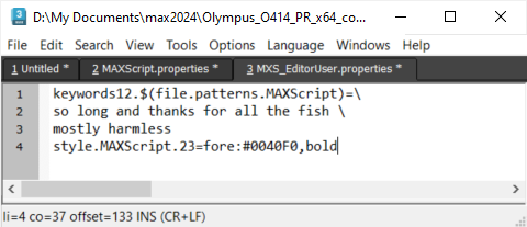

Local User Settings
On modern Operating Systems like Vista and Windows 7 with User Account Control (UAC) enabled it might be impossible to modify the factory settings provided by the MAXScript.properties file becase the file is located in the root of 3ds Max. For that reason, it is advisable to provide the custom settings using the "User Options File" also available through the Tools menu of the Editor.
If the file does not exist, it will be created automatically in the Local settings folders of the current user's account. The name of the file will be "MXS_EditorUser.properties" and it can override any settings normally found in the global "MAXScript.properties" file.
Copy the custom keywords definition and the color definition for keywords12 into this file and save it by pressing Ctrl+S:
The resulting colorization of user-defined keywords will be the same as in the examples above, but independent of the 3ds Max installation. For example, reinstalling 3ds Max but preserving the Local User settings will also preserve all overrides entered in the MXS_EditorUser.properties file.
