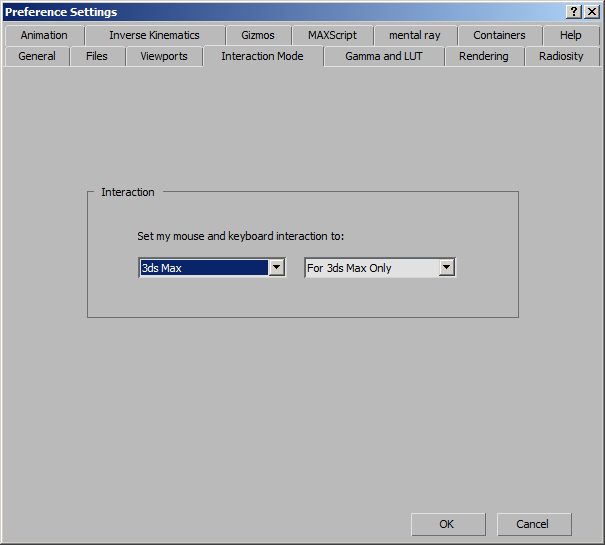

This Core Interface exposes the Interaction Mode tab of the Preference Settings dialog to MAXScript.
See also the related Interface: MouseConfigManager.
Available in 3ds Max 2013 and higher.
Properties:
IInteractionMode.CurrentMode : enum : Read|Write
CurrentMode enums: {#3dsMaxMode|#MayaMode|#CustomizedMode}
Get/set the current Interaction Mode for both mouse and keyboard.
Corresponds to the Interaction Mode tab of the Preference Settings dialog.
