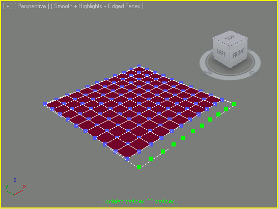

EXAMPLE:
The following code creates a plane with 10x10 segments, then collapses it to editable mesh and deletes the first 20 faces, or a whole row of quads, leaving the outer vertices isolated.
   thePlane = plane width:100 length:100 widthsegs:10 lengthsegs:10
   --> $Plane:Plane01 @ [0.000000,0.000000,0.000000]
   convertToMesh thePlane
   --> $Editable_Mesh:Plane01 @ [0.000000,0.000000,0.000000]
   meshop.deleteFaces thePlane #{1..20} delIsoVerts:false
   --> OK
The following call to the IsolatedVertices.check() method will return the isolated vertices. It does NOT require the Isolated Vertices Checker to be active in the viewport and can be used in MAXScript code to acquire isolated vertex indices into an array:
   theResults = #() --we need an array to store the results in
   --We call the method by passing the time to check at,
   --the object to check and the by-reference array to store
   --the results in. The return result of the method itself
   --will be #vertex because the method operates on vertices
   --and the content of theResults array should be threated
   --as vertex indices:
   resultType = IsolatedVertices.Check currentTime thePlane &theResults
   --> #vertex
   --If we would print out the content of the array variable,
   --it will contain the indices of the isolated vertices:
   theResults
   --> #(1, 2, 3, 4, 5, 6, 7, 8, 9, 10, 11)
