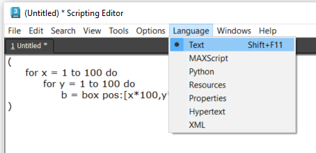

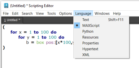

The Language menu of the Tabbed Scripting Editor contains commands for switching language-specific settings, such as syntax highlighting, indentation width, and indentation characters, between the currently installed modes:
  • Text(SHIFT+F11) - no syntax coloring
  • MAXScript - default for .ms and .mcr files
  • Python - default for .py files
  • Resources - default for .res files
  • Properties - default for .properties files
  • Hypertext - default for HTML files
  • XML - default for XML files
