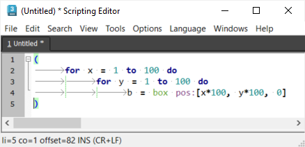

Whitespace (CTRL+SHIFT+8) -unchecked by default. When checked, white spaces like tabs and spaces will be displayed as symbols.

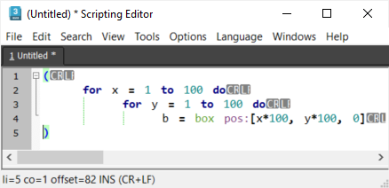

End Of Line (CTRL+SHIFT+9) -unchecked by default. When checked, end of line characters will be displayed:

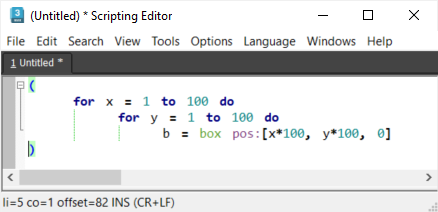

Indentation Guides -checked by default. When unchecked, the vertical guides helping align brackets and indentation will not be drawn:
Line Numbers - checked by default. When unchecked, no line numbers will be displayed in front of each line. The status bar could be used to read the current position.

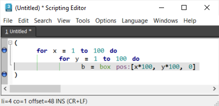

Margin - checked by default. The margin is used to display the Bookmarks.

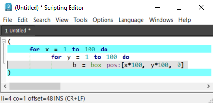

When unchecked, the margin will be disabled. To keep Bookmarks visible, the Editor will color the Bookmarked lines' background - you can still use F2/SHIFT+F2 to jump to the next / previous Bookmark and so on.
