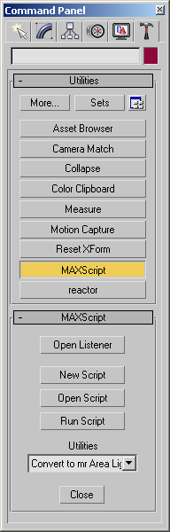

To access the MAXScript Utility panel rollout, open the Utilities panel and click the MAXScript Utility button.
The following options appear in the MAXScript rollout:
Open Listener
Opens the Scripting Listener window, or restores and brings it to the front if it is minimized or is behind other 3ds Max windows. The Listener window can also be opened by right-clicking in the Mini Listener in the 3ds Max status bar and choosing Open Listener Window; by choosing MAXScript > Scripting Listener in the 3ds Max menu bar; or by pressing F11.
For Listener window features and commands, see The Scripting Listener Window.
New Script
Opens a new Scripting Editor window used for writing a new script. A new Editor window is also opened by choosing MAXScript > New Script in the 3ds Max menu bar, or File > New Script in the Listener window menu bar.
For Editor window features and commands, see The Scripting Editor Windows.
Open Script
Opens a common File Open dialog for choosing an existing script. A new Scripting Editor window then displays the selected script. A script file can also be opened by choosing MAXScript > Open Script in the 3ds Max menu bar, or File > Open Script in the Listener window menu bar.
Run Script
Opens a common File Open dialog for choosing an existing script. MAXScript then reads and executes the selected script. Any output is printed to the Listener window. A script file can also be run by choosing MAXScript > Run Script in the 3ds Max menu bar, or File > Run Script in the Listener window menu bar.
For more information, see Running Scripts.
Utilities
Displays a list of available scripted utilities. A MAXScript defining a scripted utility must be executed before the scripted utility name appears in the Utilities list.
For more information, see Accessing Scripted Utilities.
Close
Closes the MAXScript Utility rollout. Any scripted Utilities panel rollouts are also closed.
