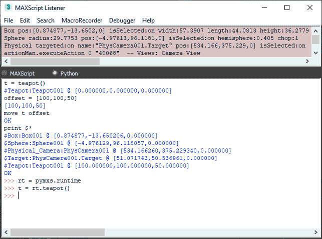

The Scripting Listener window is an interactive interpreter for the MAXScript language. MAXScript commands entered in this window are executed immediately when you press the ENTER key.
Note: The Scripting Listener also supports Python commands. You can switch to Python mode by selecting the Python radio button. The Python mode is indicated by a >>> prompt. For more information, see the 3ds Max Python Help.
The Listener window is appropriate for performing interactive work and developing small code fragments. Extended blocks of code should be developed in a Script Editor Window.
Each command you execute in Listener is actually an expression with a result which the Listener prints out after each execution.

The Listener is divided into two panes: the top (pink) pane is the Macro Recorder pane, and the bottom (white) pane is the output pane.
When the Macro Recorder is enabled, everything recorded is displayed in the Macro Recorder pane.
The output of results from scripts are displayed in the output pane.
The output of code executed in the Macro Recorder pane is always directed to the output pane so as not to clutter the recordings.
Both panes allow you to cut-and-paste, drag-and-drop, edit, select, and execute code.
You can resize the panes by dragging on the split bar between them.
