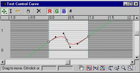

Custom Curve Control
This is a spline based control which returns output values from a user adjustable curve. An example of this control in the 3ds Max user interface can be seen in the Color Map section of the Output rollup of a 2D Texture map. Sample code using these APIs is available in \MAXSDK\SAMPLES\UTILITIES\CCUTIL\CCUTIL.CPP .
