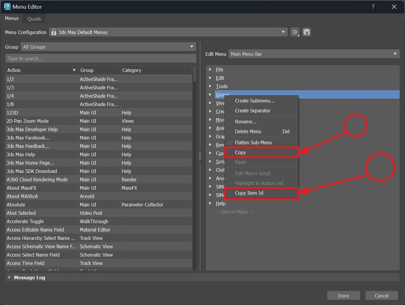

Unlike the previous system, the new menu system introduces the use of GUIDs for uniquely identifying the different menu items. When creating a new menu or menu item, you need to provide a GUID, which you can create using a number of tools (such as Visual Studio, or an online generator). You can copy the GUID for an existing menu by right-clicking it in the Menu Editor. The GUIDs for existing menu items can be seen/copied by right clicking on the menu item in the Menu Editor as shown in the image below. The copy option copies the whole menu and its submenu whereas the copy item Id only copies the selected menu/action item GUID to clipboard.

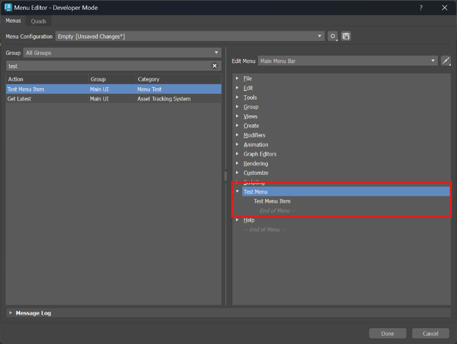

A menu definition file is the preferred way to create menu items. As such, a quick way is to open the menu editor > Under Menus/Quads, click the gear icon > select the Developer Mode. Under the developer mode, only the base and either the selected preset or an empty preset is loaded (no plug-in and user defined menus are present) providing a clean configuration to work with.
Here, selecting an existing menu item > right click > create sub menu gives a dialog to enter a submenu name. With a bare sub-menu item created, drag and drop action items from the left panel containing action items. This requires that these action items are loaded beforehand. With each added menu, submenu or action item, a GUID is automatically added for it. The created menu can then be saved as a mnx/qmnx file and shipped with the plugin (see the packaging section below).

Using the Menu Editor to create the menu definition file as shown below, we generate a file as shown:
<?xml version="1.0"?>
<MaxMenuTransformations>
<CreateMenu ParentId="00000000-0000-0000-0000-000000000000" MenuId="92c65129-c29a-49b5-b3ae-c9dcf2a2440a" Title="Test Menu"/>
<CreateMenuAction MenuId="92c65129-c29a-49b5-b3ae-c9dcf2a2440a" Id="3b183b13-21f6-4fa8-9294-c66fc0dba632" ActionId="647394-MyTest`Menu Test"/>
</MaxMenuTransformations>

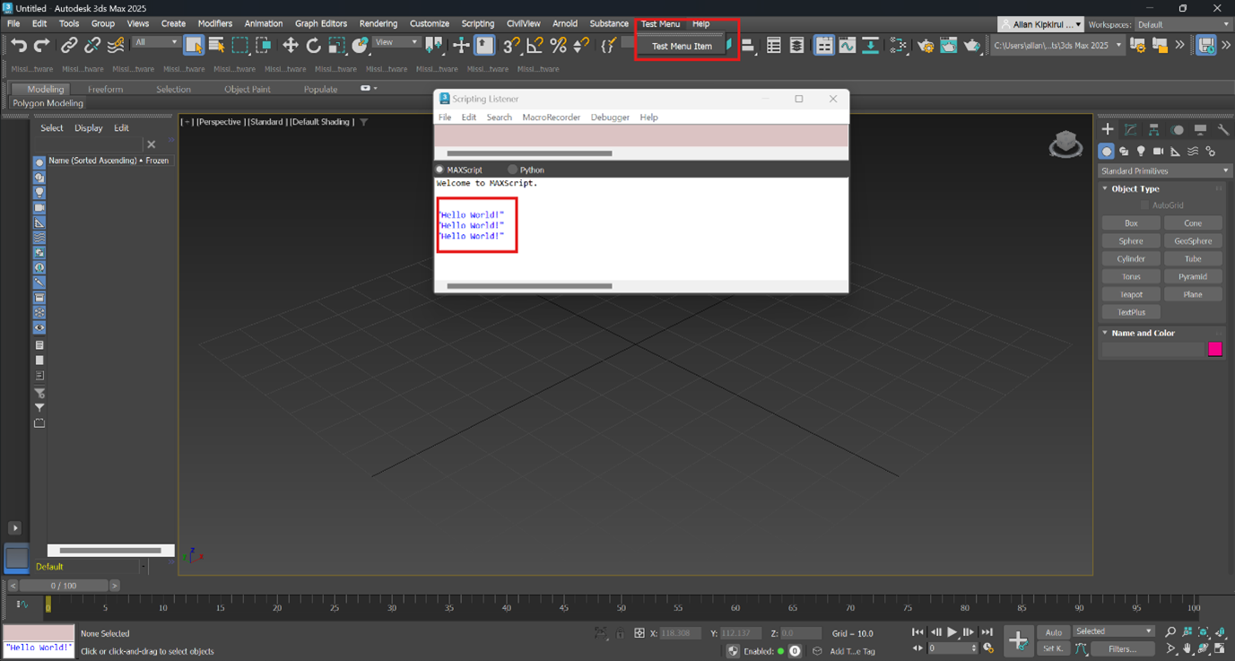

On saving the menu definition, we get the menu added, and when the action item is selected, the resultant MacroScript item gets executed, logging "Hello World" in the MAXScript listener window, as shown below.

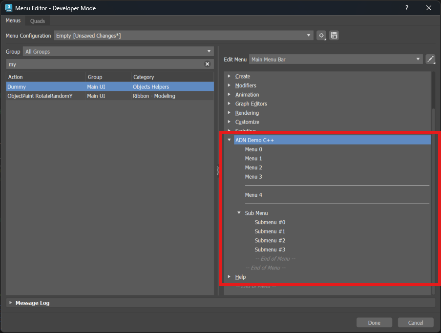

Let's look at three ways we can create a menu with both action items and sub menu items as shown below.

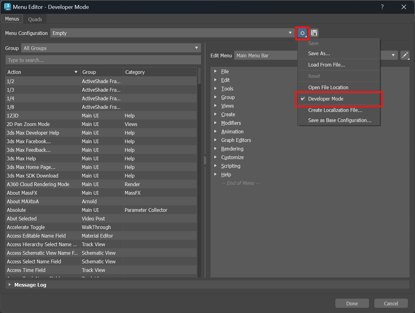

In Menu Definition (mnx): In the menu editor with developer mode activated, we select the Help item and right click to add a new sub menu before it. Once done, we search the action items and drag them to the sub menu to create the structure below. The menu can then be copied over or saved to a mnx file and packaged with the plugin.
Using MAXScript: Like our porting sample earlier, we create a sub menu item in the notification callback. From the submenu, we use it to create action items and any additional sub menu items. A script is attached for reference.
Using C++ SDK: Create a new plugin sample using the plugin wizard in VS 2022. In the DllEntry.cpp file in the
LibIntializefunction, register the function to create menus to theNOTIFY_CUI_REGISTER_MENUS.LibShutdownwill also have the unregister of the same notification. Within the callback bound above, we get the main menu bar, create a sub menu from which we add new menu items. See the attached sample. Note that delayed loading of plugins should be disabled or else the menu won't be created since the notification is fired on boot and when menu definition file loads only.Using Python (pymxs): The approach is similar to MAXScript because pymxs is a thin wrapper on top of the MAXScript. In a callback to the
cuiRegisterMenus, we add the menu items. See the attached sample as well.
