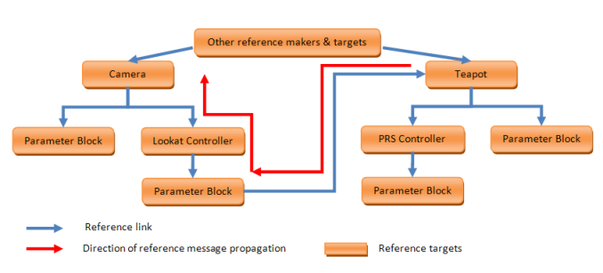

The following diagram demonstrates the reference relationship between a camera, the look-at controller, it's parameter block, and the teapot.

A reference associates two scene objects. One object is considered to be dependent upon the other. In the above example, the Look-At Constraint is dependent on the Teapot and the Camera is dependent on the Look-At Constraint controller. That is to say, if the Teapot changes in some way it needs to let other objects that might depend on it know it has changed. The controller, via the Reference, is notified that the Teapot has changed. And the controller needs to do the same for those items which depend on it. When the controller changes, it lets those items which may depend on it know. Thus the camera is notified.
In the example above, the Camera is a ReferenceMaker. It references the Look-At Constraint which is the ReferenceTarget of the Camera. The Look-At Constraint is also aReferenceMaker, it references the Teapot. In fact ReferenceTarget derives from ReferenceMaker, because anything that can be an observer, can also be observed.
