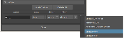

First, open the Render Settings window and go to the AOVs tab. Create a Z depth AOV.
Under AOVs, to the right of the newly created 'Z' AOV, there is a downward pointing arrow. Click on that and choose Select Driver from the menu.
- The Arnold driver should appear in the attribute editor. Select Merge AOVs. This will combine the 'Z' AOV with the rendered EXR as one file.

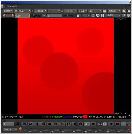

When viewing the depth AOV in Nuke, it might only show red. The Depth channel will give you non-antialiased, non-normalized depth data in the alpha channel. Non-normalized means that the Z depth values are not between 0 and 1 (distance in front of the camera), so you must divide the Z values by the far clipping plane value to get 0..1 values. This remapping is only required when viewing the depth channel in the viewer. It is not needed to make the zdefocus node work.
Z depth channel viewed within Nuke
