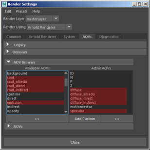

This is what we see when we look at the list of AOVs. We can see all of the above components in the AOV list, however, there are more AOVs other than what is in the standard_surface shader.
List of AOVs |
We can see some components are broken down into four AOVs, for example with coat, there are coat_albedo, coat_direct, and coat_indirect. In addition, there are also a couple of direct and indirect AOVs and there are no base AOVs, however, there are diffuse AOVs. The standard_surface simulates a physically-based shader and so the diffuse parameters are named base. Then we have diffuse, specular, sss, coat, sheen as well as other AOVs. These AOVs can be used to build the final image in a compositing software package. The AOV with the _albedo index is the pure color of our component. The texture (flat color) is given to the color parameter of the shader.

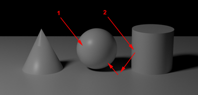

Now onto what the _direct and _indirect AOVs do. When combined together, they basically do the same thing as the diffuse AOV but separated into their light components. Whereas direct is direct rays from the light source, and indirectly reflects rays from geometry when direct rays hit them (the ray depth parameter controls how many times this ray bounce occurs). Below is a simple example:
1: direct rays come from the light source. 2: indirect rays bouncing from the surface. |
Now, if we composite diffuse_direct + diffuse_indirect, we get exactly the same result as in the diffuse AOV. The same applies to the other AOVs in the standard_surface shader.
diffuse_direct + diffuse_indirect = diffuse AOV |
