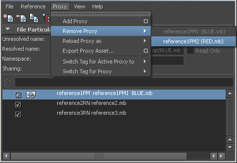

- Remove Proxy
Removes the proxy reference that is selected from the list of proxy tags that appears within the Remove Proxy submenu.
The list of available proxy references is displayed in the menu based on their proxy tags. The list of proxy tags is generated from all of the proxy tags currently in use within the proxy sets selected. When a proxy tag appears in gray, it indicates that it is currently loaded.
When a proxy reference is removed from a proxy set, and only a single file reference remains, the proxy set is removed and the reference returns to a normal reference state. In the Reference Editor, the icon is removed from the listed file reference, and the listed name of the file reference is updated.
Note:It is not possible to remove a loaded proxy. To remove the currently loaded proxy you must first reload any other proxy reference from the list so that the proxy you want to remove becomes available within the list for removal.
