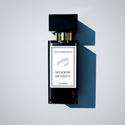

Improved, more realistic shadows for glass objects
Transparent objects like clear glass now cast shadows. The look of the shadow is controlled by the new transmission_shadow_density parameter on theopenpbr_surface and the standard_surface shaders. (ARNOLD-6881, ARNOLD-15863, ARNOLD-15828)
0 0.5 0.9 1
Transmission shadow density = 0 Transmission shadow density = 1
Caustics off
Caustics on

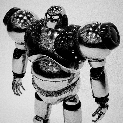

Improved Global Light Sampling (GLS) on glossy materials (MtoA 5.4.8)
GLS now takes material glossiness into account when sampling, which greatly enhances the quality especially when many small lights are present. It causes small slowdowns for fixed AA renders, but for adaptive renders, it brings overall speedups. For example, with adaptive in the robot scene below we achieved 1.7x speedup. This feature can be enabled and disabled using GLS_glossy_enable. (ARNOLD-15489)
7.3.5, fixed AA 7.3.7, fixed AA

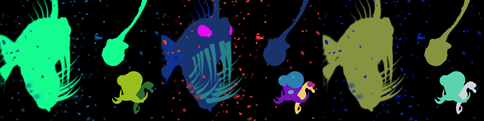

Optimized Cryptomatte and GPU support
Arnold now has an internal implementation of Cryptomatte that adds support for GPUs and improves performance on CPU. Cryptomatte now consumes less memory for samples, making it easier to use higher AA settings, progressive rendering, and adaptive rendering (when properly used with FIS). In a simple scene rendered at 640x480 resolution with three cryptomattes the below table shows improvements in peak memory. (ARNOLD-11042)

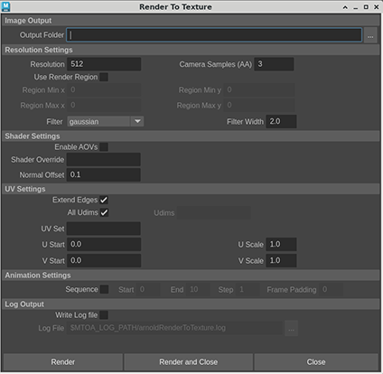

  • Add logs for Render To Texture: A new option -log has been added to the arnoldRenderToTexture command and to the UI, to allow users to produce a render log for debugging issues (MTOA-2181)

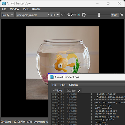

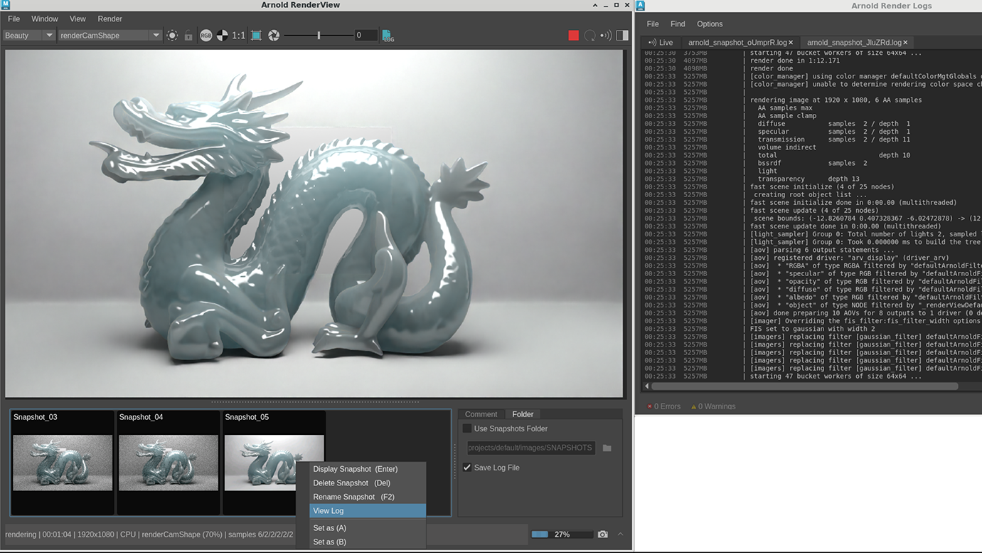

  • Arnold Render View - Log Viewer: Add tabs for viewing saved logs and loading log files: Tabs have been added to the Log Viewer to allow you to copy from the live log and load log files from disk (ARNOLD-15640)
  • New Arnold RenderView Icons: Arnold RenderView has had new improved DPI-aware icons (ARNOLD-14264)

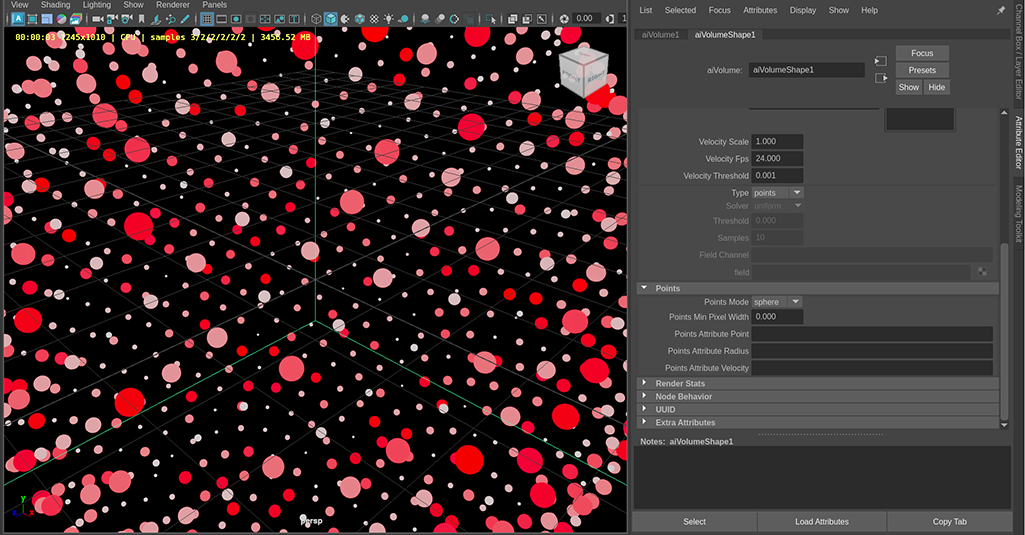

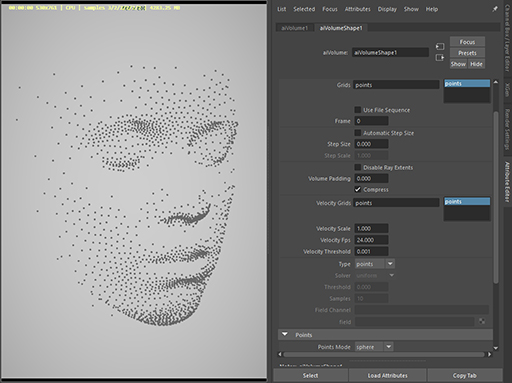

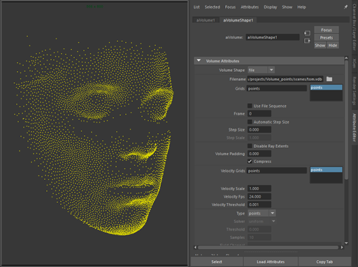

  • Faster OpenVDB volume intersection: Intersecting OpenVDB volumes are optimized for many-cores. Scenes where volume::intersection is a sizable component of render time can see large speedups. One scene where it accounted for 73% of render time on a 128-core machine saw the volume::intersection time drop to 16% of total time, for an overall 3x speedup in render time. (ARNOLD-15448)

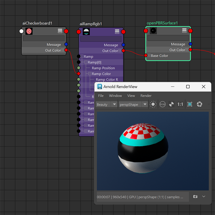

  • Linked color and positions in ramp shaders on GPU : Arnold GPU now supports the linking of individual ramp parameter components for the position, value, color, and interpolation parameters. (ARNOLD-7120)

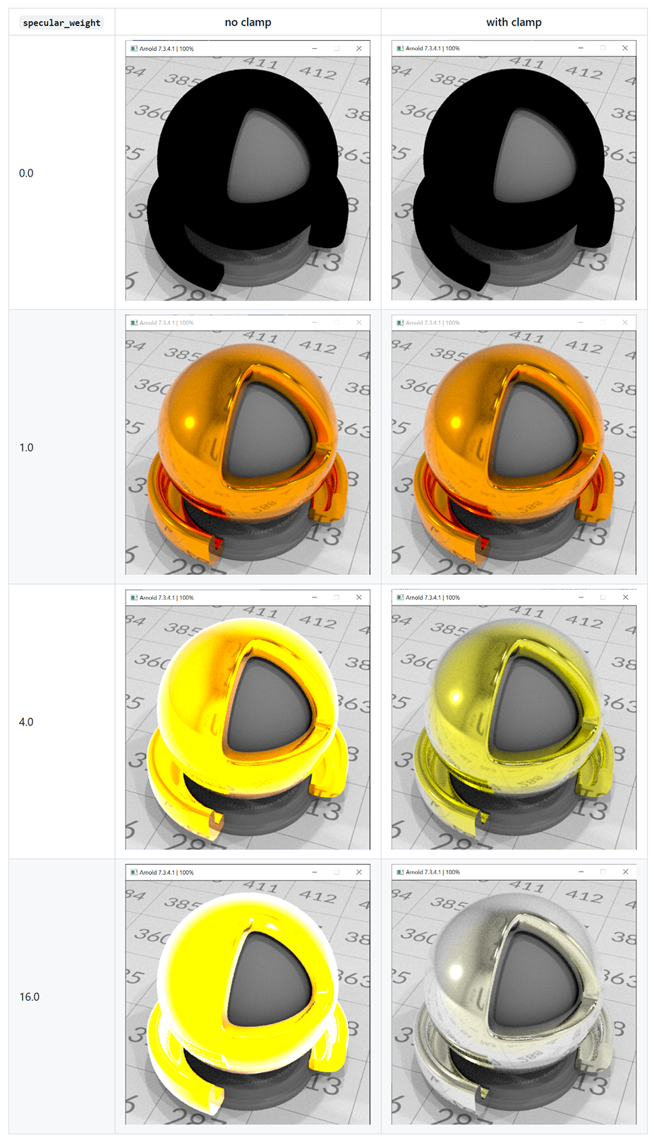

  • Corrected clamping of OpenPBR metallic lobe: The OpenPBR metallic lobe Fresnel previously exhibited energy gain when the specular_weight parameter was increased above 1. This has been corrected so that the Fresnel conserves energy in this case, saturating to a mirror reflection in the limit of high specular_weight.
