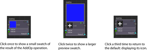

Preview swatch
Click the
Render Swatch icon
on the top of each node to cycle through displaying: its icon, its small render swatch, and its large render swatch.
In the following example, clicking the Render Swatch icon a first time shows a small swatch of the result of the AddOp operation. Clicking Render Swatch a second time shows a larger preview swatch. Clicking Render Swatch a third time returns to displaying its icon.
This functionality allows convenient visualization and debugging of your shading graph.

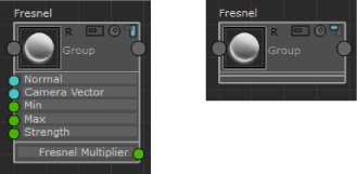

View mode
Click the
Hide Inputs and Outputs icon
on the top of each node to toggle between displaying the node attributes and hiding the inputs/outputs for a more compact node view.
