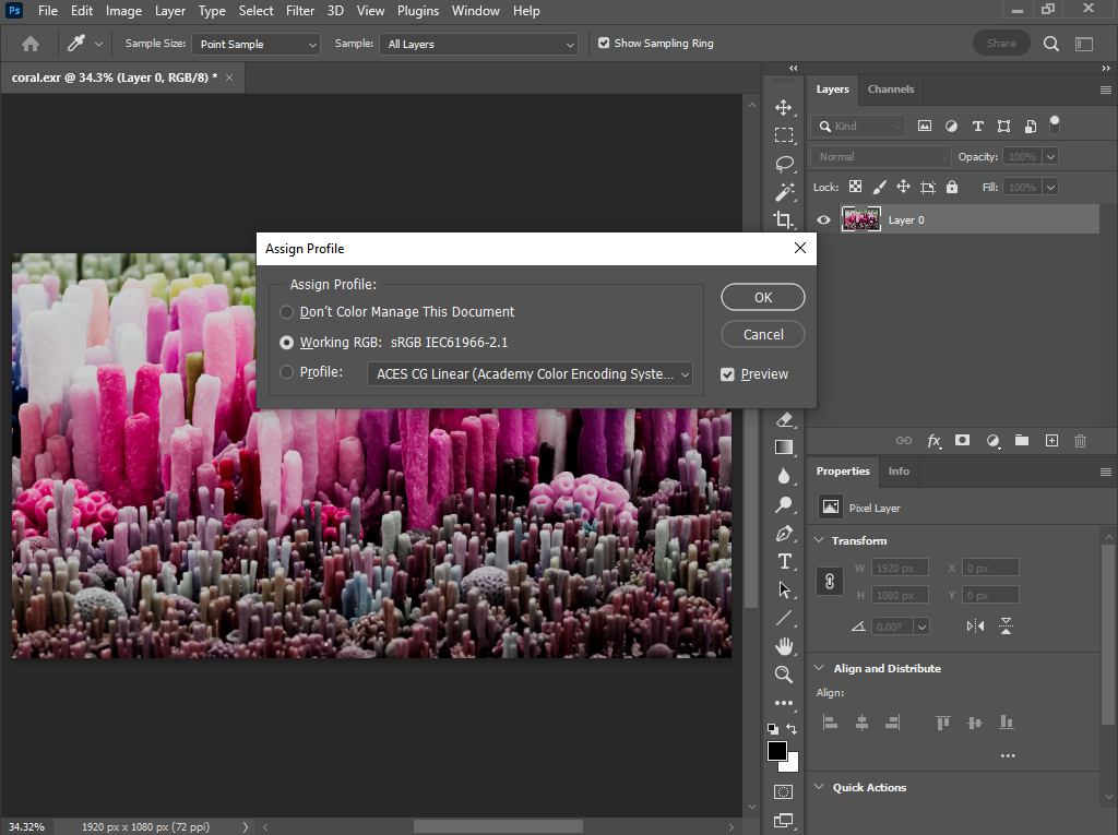

  2. Edit -> Assign Profile -> “ACES CG Linear (Academy Color Encoding System AP1)”

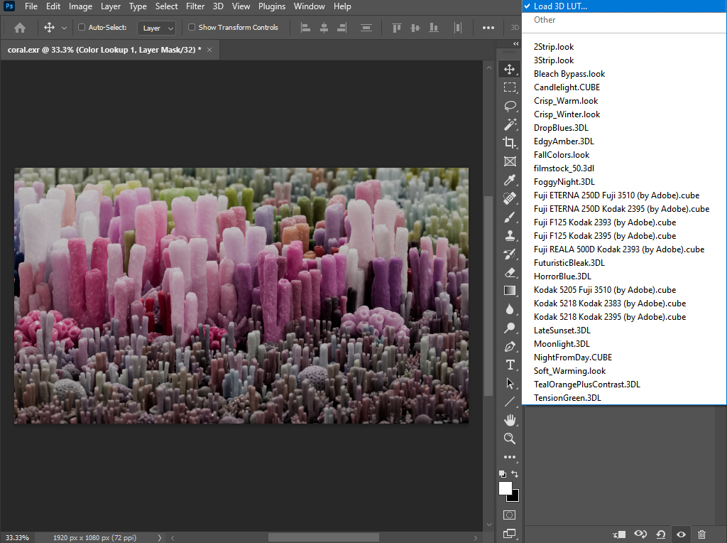

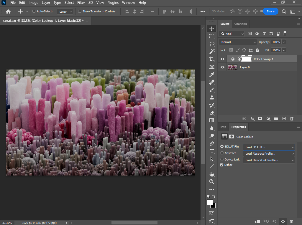

  1. Layer -> New Adjustment Layer -> Color Lookup -> Load 3D LUT
  1. Select Load 3D Lut in the Properties tab.
  1. Choose Load 3D Lut from the top of the menu.

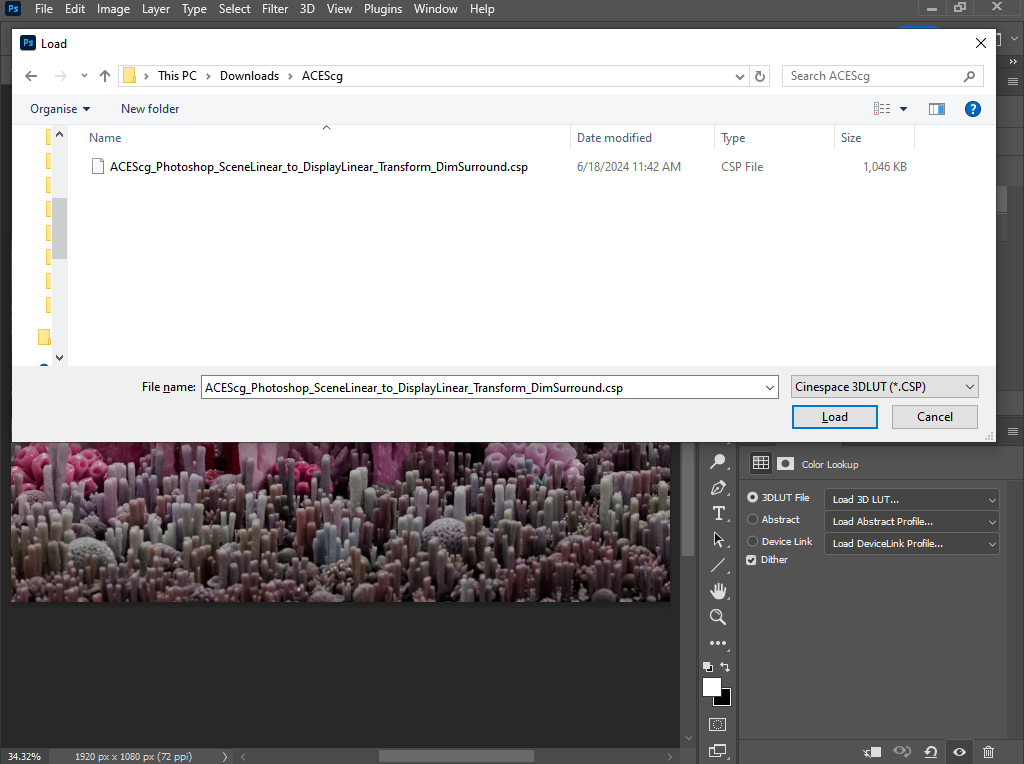

  1. Navigate to ACEScg_Photoshop_SceneLinear_to_DisplayLinear_Transform_DimSurround.csp
