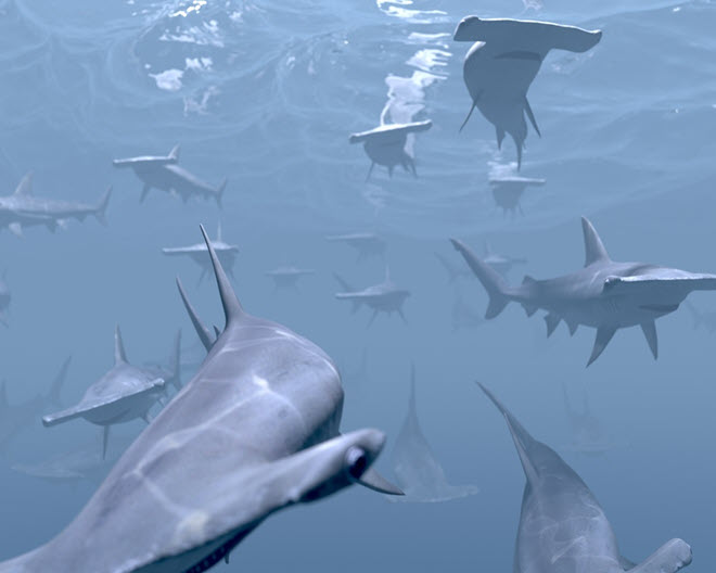

Sharks! The subject matter for our underwater scene
In this tutorial, we will cover lighting and rendering an underwater scene with a school of sharks. We will setup the scene with fog to achieve an under water feel to the scene. We will cover lighting the scene using a gobo to create a fake caustic effect. We will also go through creating the sea material using vector displacement.

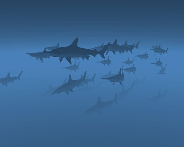

  • We will start off by creating some fog for our underwater scene. Open the Render Settings window. Under the Environment attributes, change the Atmosphere from none to Fog.
  • You should see the Fog attributes in the attribute editor. Increase the Distance a small amount to something like 0.02 and render the scene. You should get something that looks like this:
Default fog settings. Ground point is Z by default.
Ground Normal
  • Change the fog color to a mid blue and change the Ground Normal to Y up by entering 1 in the Y axis field and 0 in the Z axis field. The sharks are going to be near the surface of the sea, and so we want to give the impression that light is coming from the top and attenuates in the Y direction.
Ground Normal 1 (Y-Axis)
Distance
  • We now want to increase the amount of fog. Increase the Distance value to around 1.
Distance increased to 1
Height
  • The sharks at the top are not receiving much fog. Increase the Height value. This will push more fog to the top of the scene and will make the scene look more convincing.

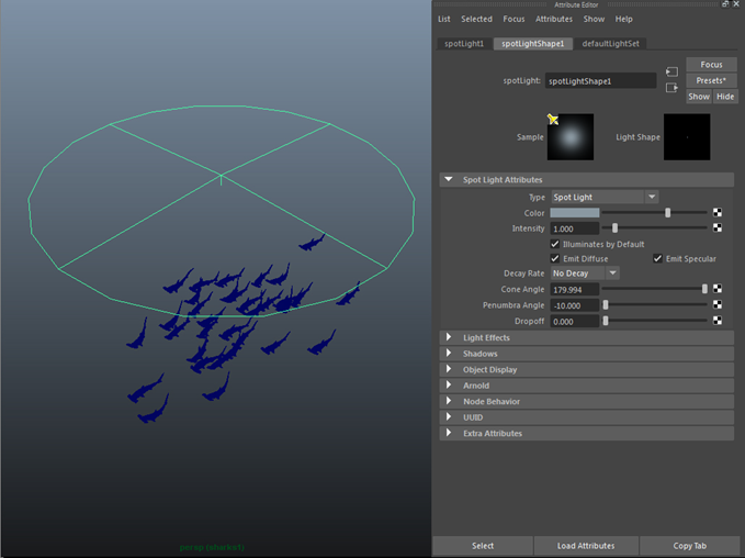

Now we need to cast some light in the scene. We will use a spotlight. This will enable use to add some light filters to it that will give us more control of the lighting in the scene.
  • Create a spot light and increase the cone angle so that it covers the entire renderable scene. In this case, we have used a cone angle of 175. Increase the intensity or exposure enough so that the sharks are visible.

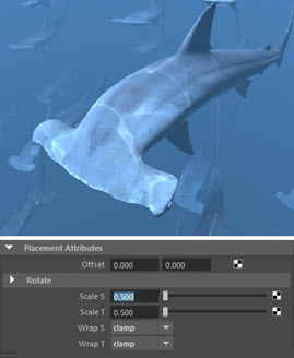

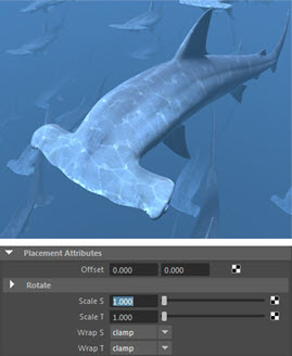

  • Test render the scene. Using the default settings, the scale of the caustic effect looks too small. Reducing the scale of the Scale S and T values increase the scale of the caustic texture used for the Slide Map.
Gobo Scale S T set to 1. The caustic pattern is too small. Lowering the Gobo Scale S T to 0.5 creates a larger caustic effect

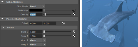

  • The gobo effect appears a bit strong. We can reduce its effect by increasing the Density value. Try increasing it by a small amount to 0.5. This looks better.
Density decreased to 0.5

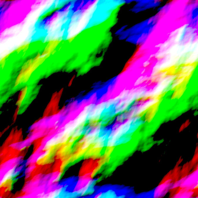

To get a more realistic wave effect, we will use a vector displacement map to displace the sea waves. This will displace the sea geometry around a direction different from the normal, unlike a traditional displacement map which displaces the geometry in one direction only. More information about creating an ocean surface can be found here.
  • Connect the file texture below to a Maya displacement node. Connect the displacement node to the shading group of the Ai Standard used for the sea.
Texture map used as the Vector displacement for the sea
  • In the Arnold attributes for the sea polygon plane, change the Subdivision Type to Catclark and increase the number of Iterations. Start off with a low number of Iterations and increase them until you get something that looks realistic. Higher values will increase memory use and render times, so be careful not to go too high with this value initially.

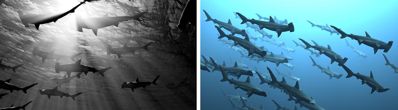

Below you can see the final render from Arnold (left image) and after it has been tone mapped and color corrected (right image):

Below are some alternative example renders using other nodes such as atmosphere_volume and a skydome_light for further control of the underwater effect.
Ai Gobo caustic effect
