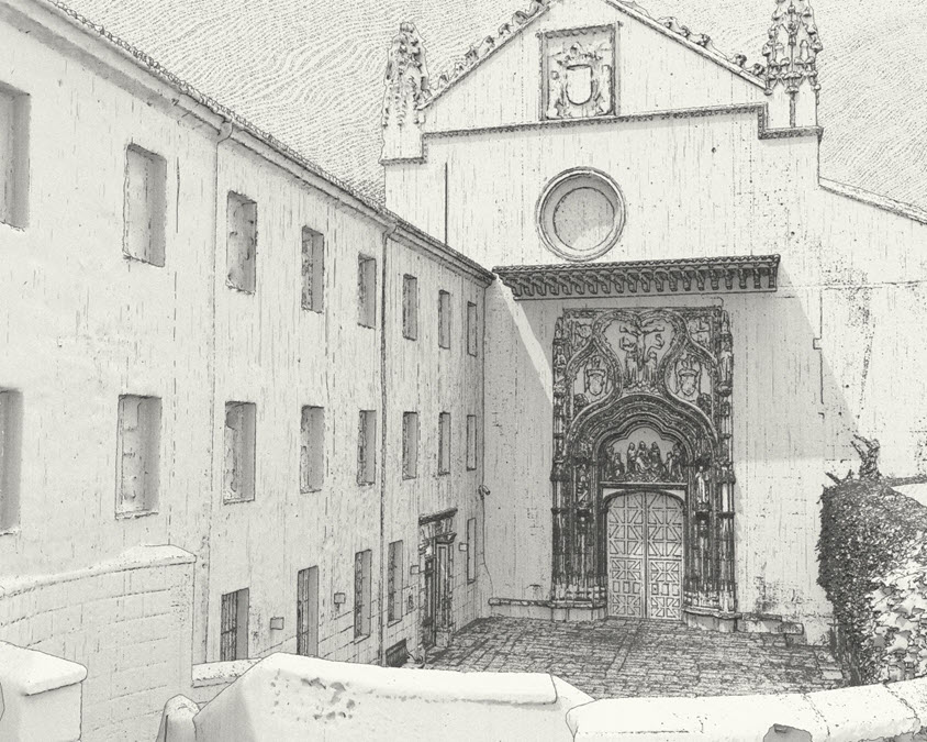

This short tutorial covers how to create an old, worn 'illustrative' sketch-style using the Toon shader to create the above image. It covers how to use Base Tonemapping and Edge Detection in combination with bump mapping using a Noise shader to create a hatching effect. Thanks to Javier Garcia-Lajara Herrero for the use of his convent model.

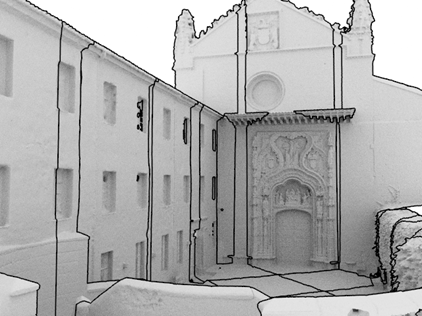

- Create a skydome_light and render the scene. It should look something like this.

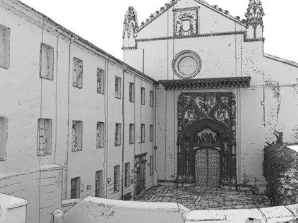

Edge Detection
- Reduce the Angle Threshold to around 20 (Toon-> Edge Detection). This will give us more detailed edges around the geometry.
- The Edges appear too thick and black. We can fix this by reducing the Edge Width Scaling to around 0.4.

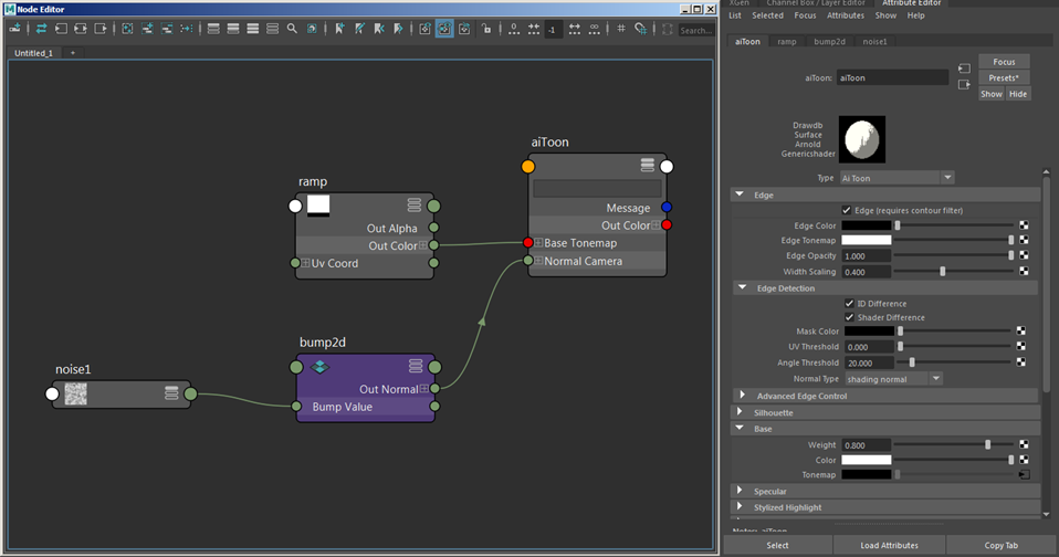

- The Base shading looks too dark for the illustrative effect that we want. We can adjust this by using a ramp to determine how the Base shading is affected by the lighting in the scene. Connect a black and white ramp to the Base Tonemap and increase the amount of white in the ramp until it looks like the image below.

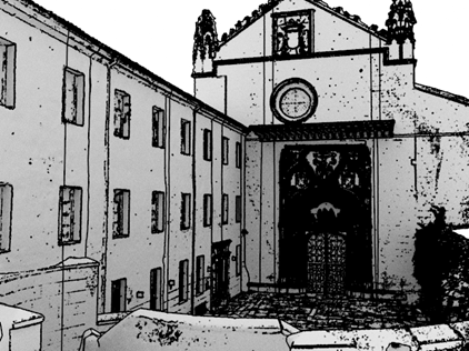

Without Base Tonemap | B&W Ramp > Base Tonemap |

- Connect an Arnold Noise shader to Geometry -> Normal (bump mapping) in the Toon shader.
- Increase the number of Octaves to 8. Reduce the Scale in Y to 0.01. This will stretch the noise in the vertical direction and give the impression of a hatching effect.

Final Rendering
- Connect an HDR map or a physical_sky to the skydome_light.
- You could also add a pale yellow base and emission_color to the Toon shaders to give a worn paper effect.
- Try adding a similar shading effect to the sky using a polygon plane behind the geometry as used in this case.
Final shading network
