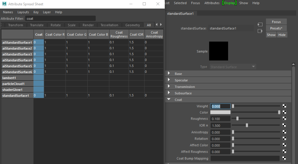

Tip:
Converted standard_surface shaders render black Phong reflectivity values convert to coat_weight: 1. This may cause any newly converted standard_surface shaders to render as black. If that is the case, try setting coat_weight to 0.
