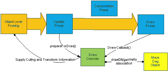

The actual draw occurs on every refresh, and consists of two stages: preparation and execution.
Any required data from the Maya dependency graph must be retrieved and cached in the prepareForDraw() stage. It is invalid to pull data from the Maya dependency graph in the draw method and Maya may become unstable as a result. Implementations may allow Maya to handle the data caching by returning a pointer to the data from this method. This same pointer is passed to the draw callback. On subsequent draws, the pointer is also be passed back into the prepareForDraw() method so that the data may be modified and reused instead of reallocated.
In the draw method, the override is free to act as necessary to draw the object (apart from triggering evaluation of the Maya dependency graph). Access to device information can be obtained through MDrawContext, and the override can make use of MStateManager and MTextureManager to handle device state and resources. If the override needs to modify the state (in any manner), to avoid draw corruption, it must be sure to restore that state before completing execution.
Figure 44: The draw override supplies transform and bounds information for any culling, will be called to perform draw preparation during the “Update Phase” and then called to perform drawing during the “Draw Phase.” Intermediate phases between updating and drawing are skipped over.
