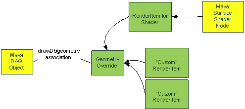

Figure 38: An MPxGeometryOverride
is associated with a given DAG object by its classification string. Shown is a possible configuration where render items from an internal surface shader as well as custom render items are part of the set of render items that the override would handle.

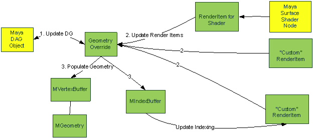

Figure 39: The three phases are used to label the connections between the main constructs which are involved in the update of an MPxGeometryOverride
. The first phase (1.) involves accessing the associated DAG object. The second phase (2.) updates the render items and determines the geometry requirements. The third phase (3.) updates vertex and index buffer data and the indexing association for each render item. In this example, three render items drive the update requirements: one for an associated surface shader and two for custom render items that the override wishes to draw.
