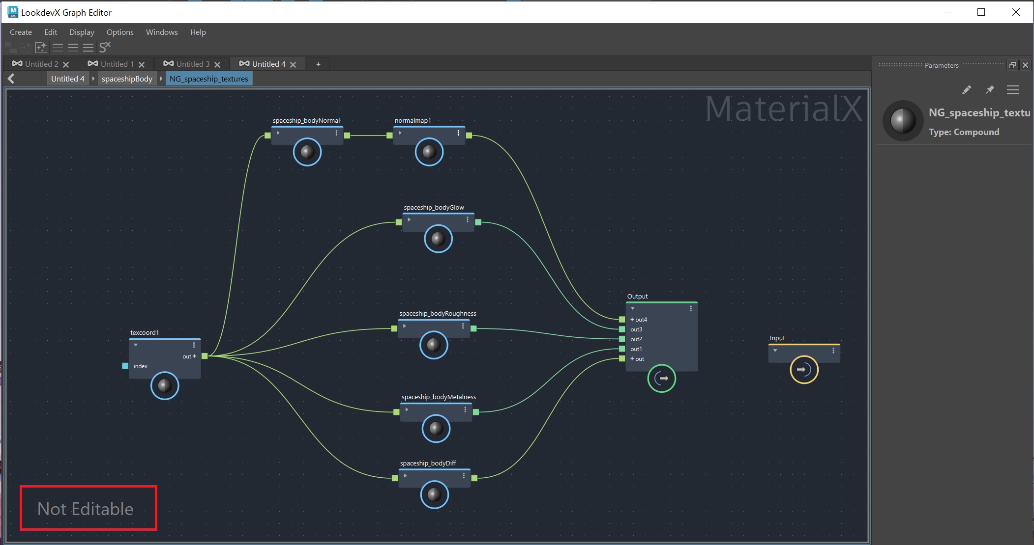

Viewing a node definition
After importing a published Compound, you can view the node definition by right-clicking on the Compound and choosing "View Definition". This action will "dive into" the Compound and display the underlying graph that makes up the Compound. By default, the node definition is not editable as indicated by the "Not Editable" label in the bottom left corner of the LookdevX graph.
