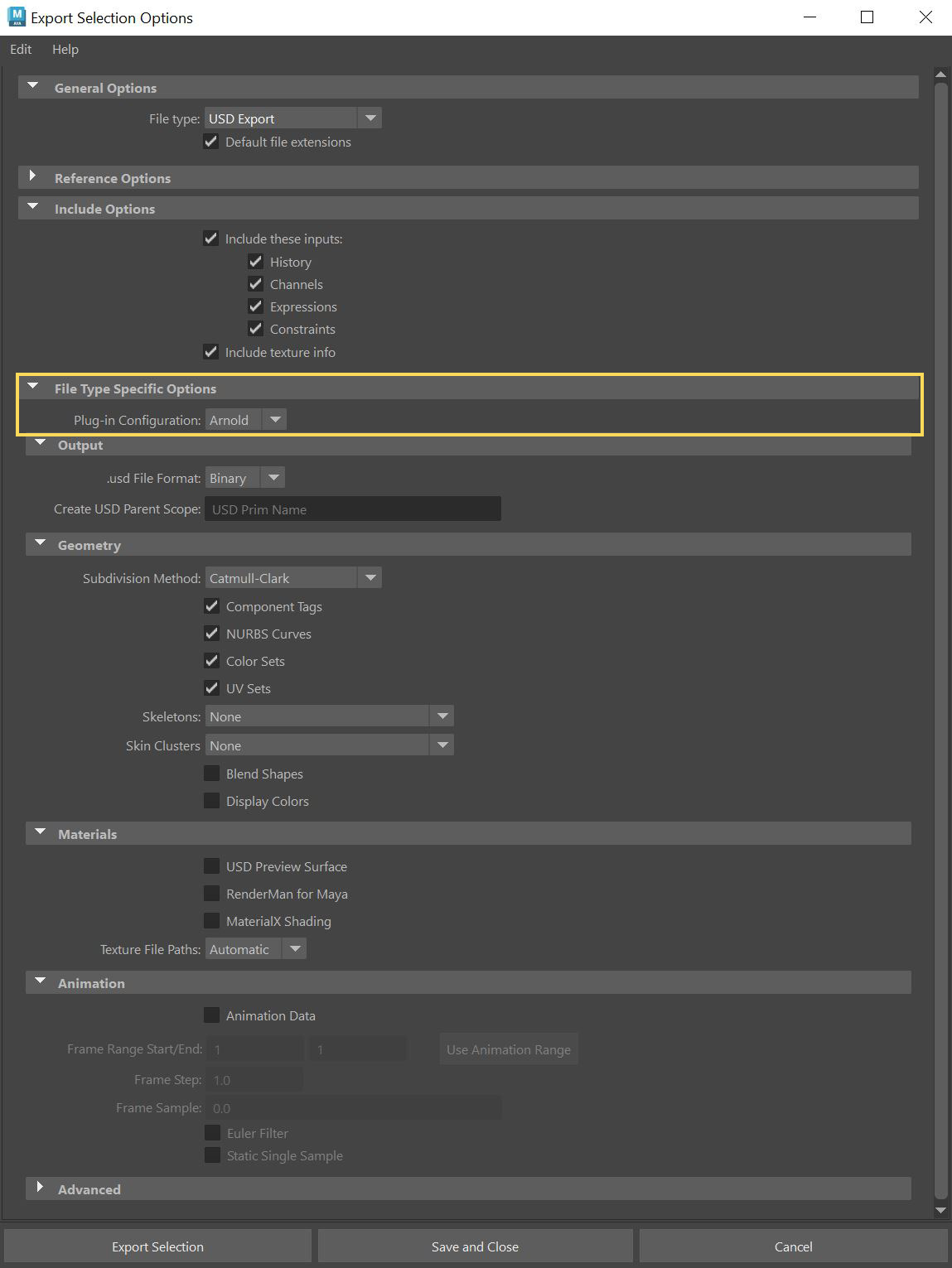

To export them as Arnold shaders, select Arnold for the Plugin Configuration under the File Type Specific Options.

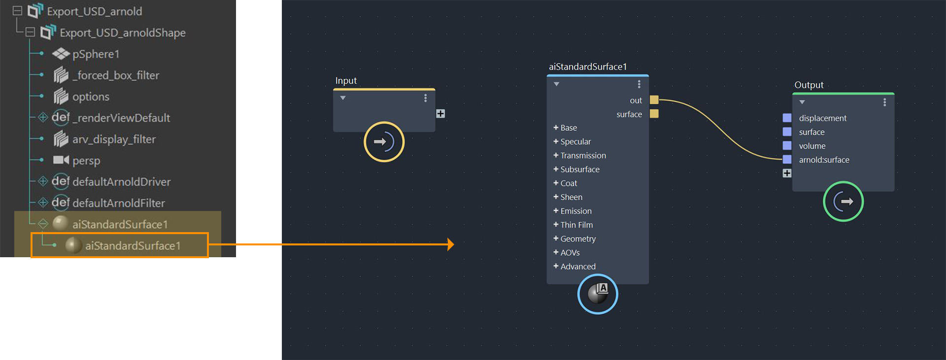

When you open the exported USD file, the material appears in the Outliner as indicated in the screenshot below. You can then access and edit this material in LookdevX.

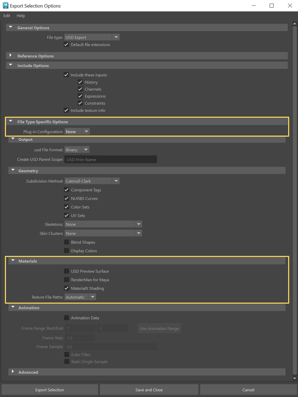

To export them as MaterialX shaders, apply the following settings:
  1. Select None for the Plugin Configuration under the File Type Specific Options.
  2. Select MaterialX Shading under Materials
USD export MaterialX image 1

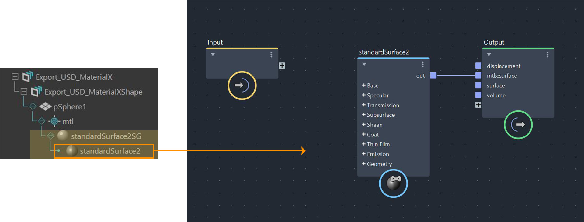

Similar to Arnold shaders, the material is listed in the Outliner when you open the exported USD file, as shown in the screenshot below. This material is accessible and editable within LookdevX.
