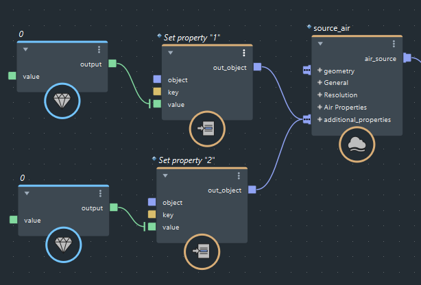

Connect the output of the
set_property
node to theadditional_properties
port of a source node.
You can connect have any number of set_property
nodes connected into a source
node.
