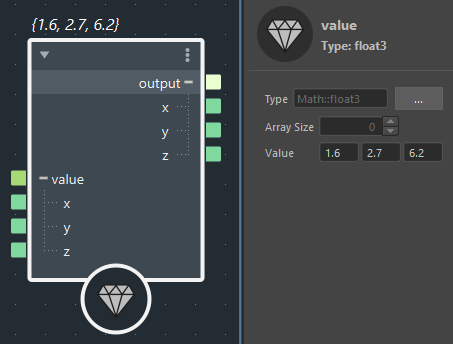

A `float3` `value` node
By default, value nodes show their values instead of their names, except for types like matrices and objects. You can switch between displaying names and values by selecting the node and choosing Display > Show Node Names.

Once you have added a value node, you can set the node's value in the Parameter Editor, or change its data type first.
Value node
Change the data type of a value node
The current type of a value node is displayed in the Parameter Editor. To change it:
  1. Click the More button (...).
  2. Select a new type.
If the type is an array, you can set its size and the default value for all elements in the Parameter Editor.
If the type is a vector or matrix, you can access ports for its components using the + and – icons.
